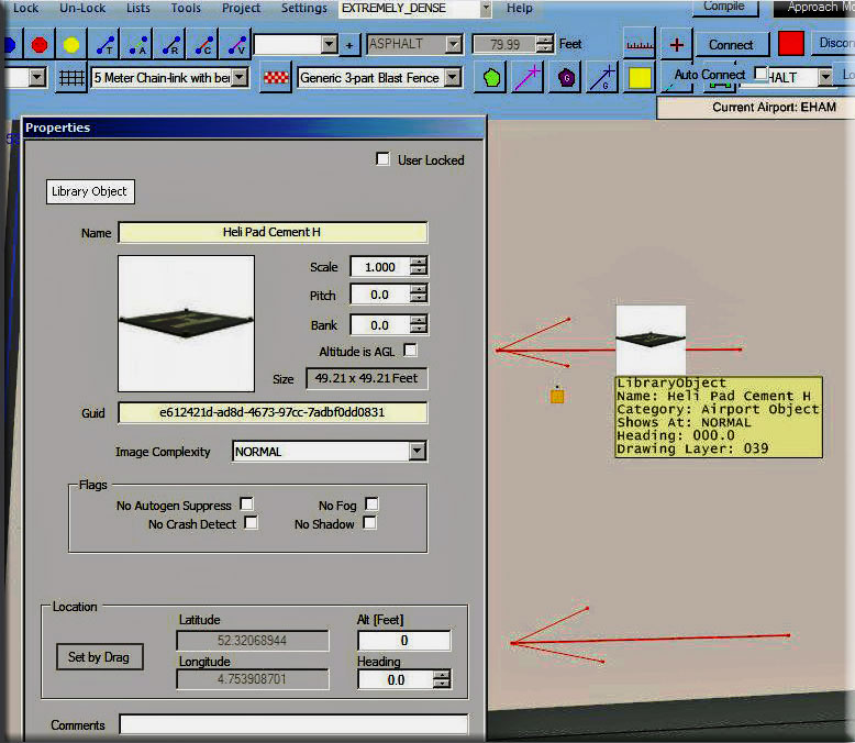

Helipad Elevation Problem/Solution
Helipad Elevation Problem - by Steve Weinkamer
Problem: Using ADE, placing a helipad at a radically different location/altitude, can cause the "start" for the aircraft to be below the helipad (at ground level).
METHOD #1
Place a small flatten under the pile of rocks object and then placed the helipad object just resting on the flatten, which is 99% hidden by the rock object. Also adjusted the helipad’s starting altitude in ADE dialog (I have the ProKey addition which makes this pretty easy. Can also be accomplished by hand editing the airport/helipad 4’s xml properties in notepad.)
METHOD #2
  • By default, scenery objects clamp to the ground (AGL).
  • Make sure you select one of the scenery object heli pads from the "airport-Objects.bgl.
  • In the property window, uncheck the Altitude is AGL. Change the altitude to match the height of the building, plus the amount of feet above sea level the building is sitting at. example, if the building is 80 feet tall and the MSL is 500 ftl, then set the altitude to 580 feet.

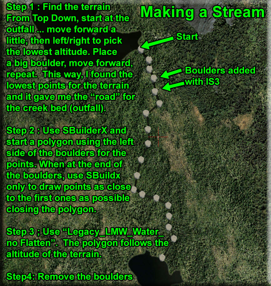

River/Stream Addition
Making a River come down a mountainside - (Following the terrain without having to put altitude into each of the points.
example
For a realistic looking "stream", edit the polygon to make it extremely narrow, this keeps you from having a blue "gash" across the scenery, it is also easier to "landscape" blocking out the sharp turns.
